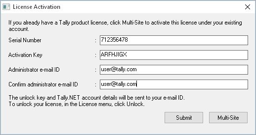

Activating Single Site Account
To activate a single site account
1. Start Tally.Developer 9 .
2. Go to License > Activate .
The Activate License form is displayed as shown below:
3. Enter the details in the Activate License form, and click Submit .
A confirmation message is displayed on successful activation.
T o unlock the license file see, Unlocking License .
Note: The account related information like serial number, activation key, unlock key, and so on is sent to the e-mail ID specified in the Activate License form.

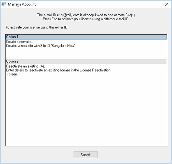

The User Resolution screen appears as shown below:
6. Select Option 1 to activate a new site and click Submit .
Or
6. Select Option 2 to reactivate an existing site, and click Submit .
7. Reactivate License screen appears, enter the email ID and password. Click Submit .
The Reactivate License Resolution screen appears, displaying a list of sites.
8. Select the required site, and click Submit to reactivate the license.
