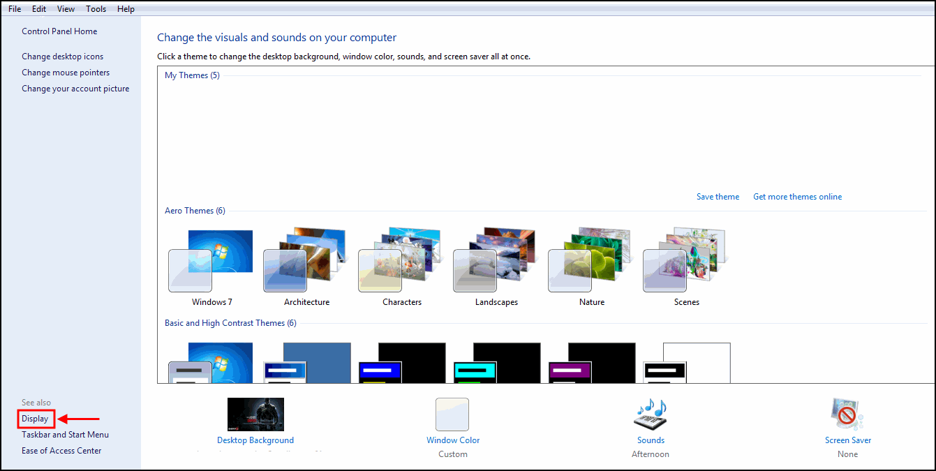

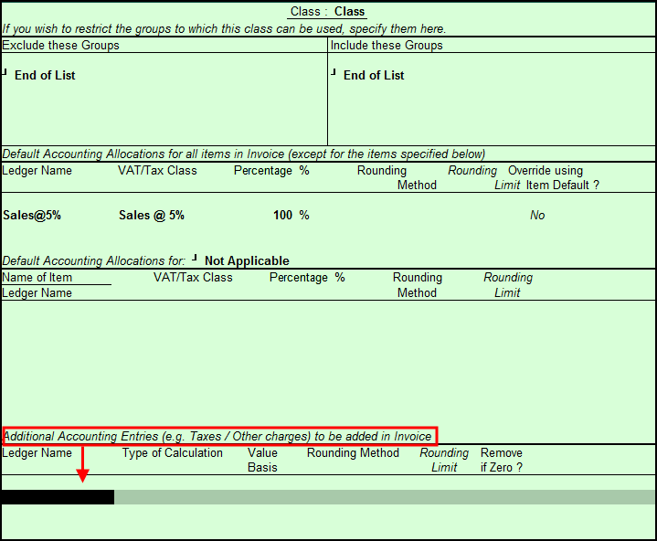

In voucher class, cursor is not moving beyond the
Default Accounting Allocations
for field:
Follow the checklists in order to resolve this issue.
1.
Right click on your Windows desktop.
2.
Click
Screen resolution
. Screen resolution should be set to recommended settings.
3.
Right click on your Windows Desktop.
4.
Click
Personalize
and
Display
If display settings (for eg: - larger-150%) and Monitor is small in size then details will not fit into the screen. Thus cursor will not move to the additional accounting entries under voucher class.
1.
Set default settings to (Smaller—100% (Default)) > Click
Apply
2.
Restart the system and check.
Cursor will move to additional accounting entries under voucher class.
