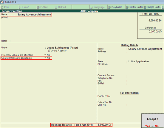

Let us take an example
of Salary Advance account having an opening balance of Rs.5,000 consisting
of Cost Centres, namely, Employee A Rs.3,000 and Employee B Rs. 2,000.

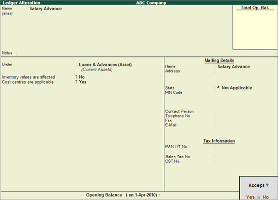

1.
Alter
the ledger Salary Advance and remove the opening balance of Rs.5,000
as shown below:
2.
Save
the ledger.
3.
Create
another ledger Salary Advance Adjustment account under
Loans
& Advances
4.
Set
No
to
Cost
Centres are applicable?
5.
Enter
Opening Balance
as Rs.5,000/-
6.
Save
the ledger.

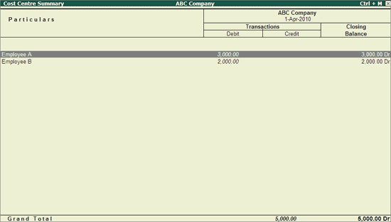

9.
The
Cost Centre
Summary
report displays the opening balance as shown below:

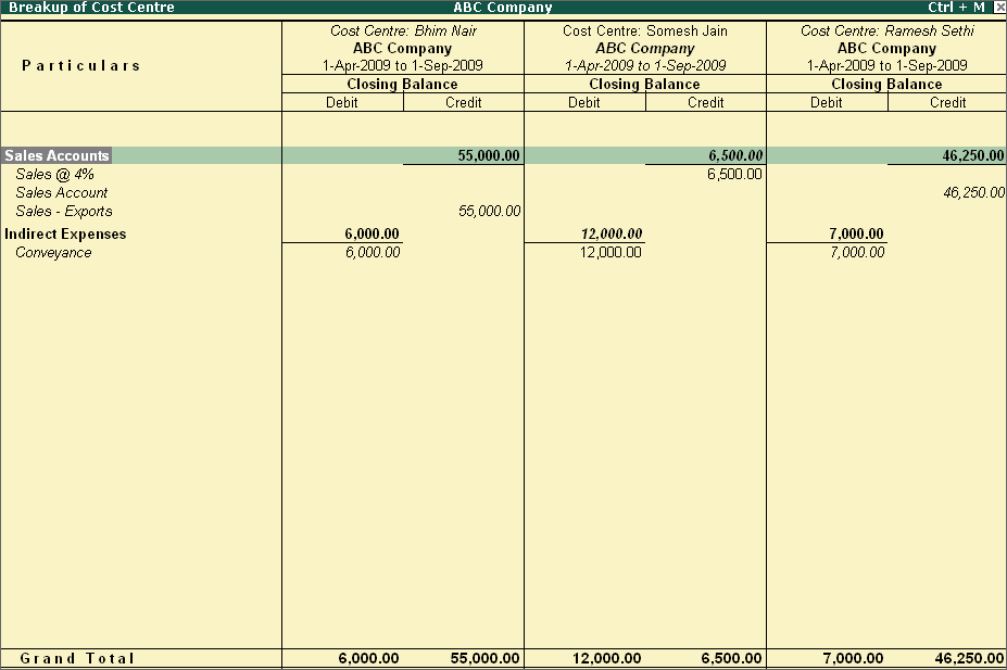

Cost Centres in Tally.ERP
9 enables you to analyse a particular transaction from multiple
angles. It reduces the need for creating more ledgers for the purpose
of gathering information for analysis.
Cost Centre could generally
be a unit/ division/or department in the organization. You can allocate
your expenses or revenues to each cost centre and extract reports
for that cost centre. Tally.ERP 9 also allows you to compare
one cost center with another.
The management is able
to measure performance of each cost centre, based on these reports.
1.
Go
to
Gateway of Tally
Display
Statements
of Accounts
Cost Centres
Cost Centre Break-up
2.
Select
a cost centre.
3.
Use
New Column (Alt+C)
option to
bring up the data of another cost centre for comparison alongside.

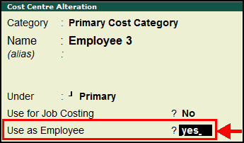

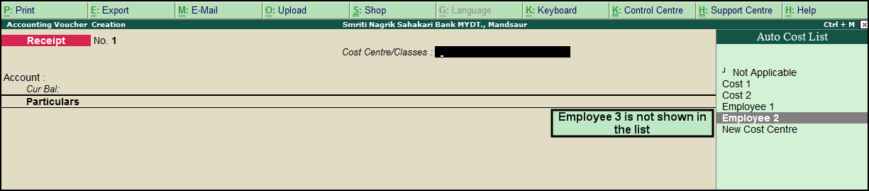

screen, if the option
Use as Employee
is enabled, then such cost centres will not appear while recording
journal/receipt/payment transactions.
For example, a cost
centre by name Employee 3 is not listed under Cost Centre Class.

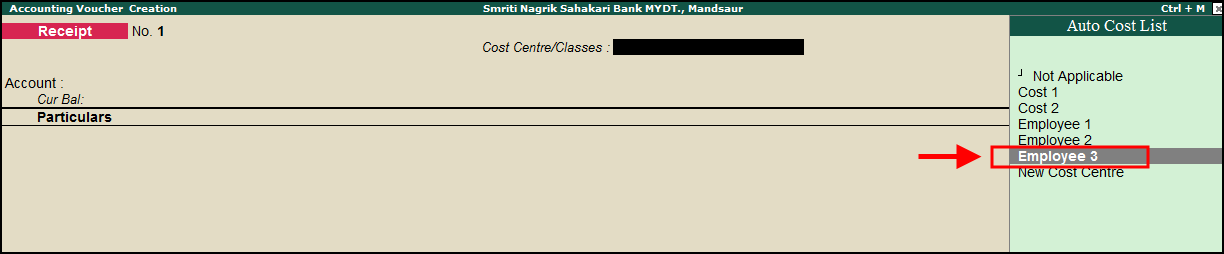

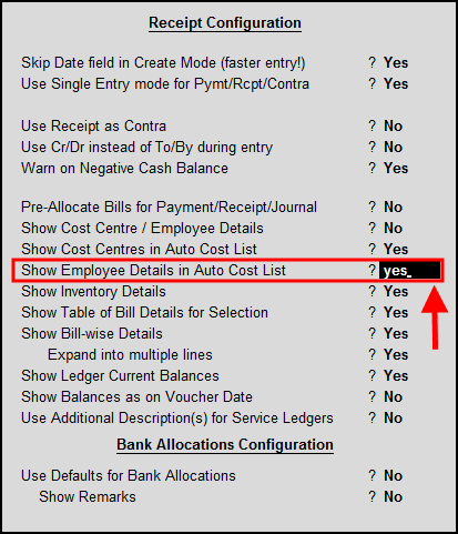

In Journal/Receipt/Payment
voucher, press
F12
and enable
the option
Show Employee Details
in Auto Cost List
Now, the Cost Centre
which is used as an Employee (Employee3) will displayed in the list
as shown below:
