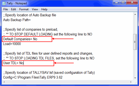

a.
Open Tally.ini file from Tally folder and edit the Tally.ini and set the following parameters as shown:-
o
Set Default Company = No
o
Set User TDL = No
Note
: In case you are able to start Tally.ERP 9 after setting the default companies to No, it is suggested to take a backup of the data and re-write the default companies.

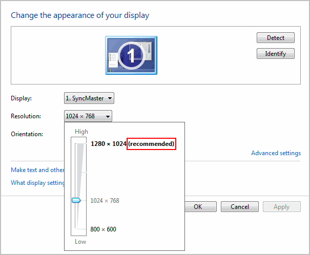

b.
Check Screen resolution.
o
Right-click on the
Desktop
and select
Screen resolution
or
o
Go to
Start > Control Panel > All Control Panel Items > Display > Screen Resolution
o
Select
(recommended)
o
Click
Apply
o
If the problem persists, set the resolution to
1024*768
