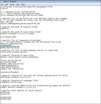

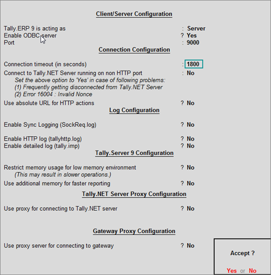

1. In F12: Configure > Advanced Configuration , set Connect to Tally.NET Server running on Non HTTP Port to Yes on the remote server.
2. Open the Tally.ini file available in the Tally folder, and add the parameter Importbatchsize=5 , as shown below:
3. Go to F12: Advanced Configuration and enter 1800 in Connection timeout (in seconds) , as shown below:
After the above configuration you can synchronise or access the data remotely, or perform any licensing activity successfully.

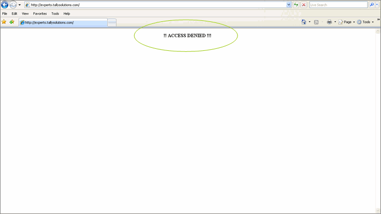

For Licensing Issues
● Open Internet explorer a type http://experts.tallysolutions.com/
You will receive a message “!! ACCESS DENIED!!!”.
The above message indicates that you are unable to reach the License Server.

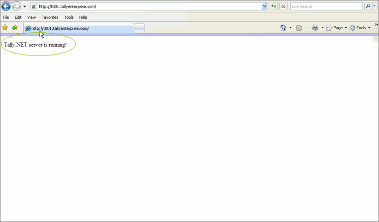

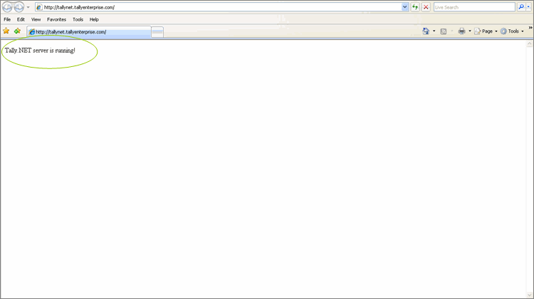

● Open Internet explorer and type http://tallynet.tallyenterprise.com/ – you will receive a message “Tally.NET server is running!”
Also check the following URL and open Internet Explorer and type http://t001.tallyenterprise.com/ - you will receive a message “Tally.NET server is running!”
The above message indicates that the communication to the Tally.NET server is successful through Internet explorer.

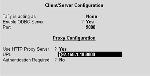

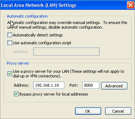

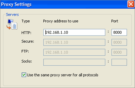

All your internet access may be happening via a proxy server in your LAN. This is acting as a gateway.
1. Check whether proxy is enabled.
a. Open Internet explorer > Tools > Internet options > Connections > LAN Settings > Proxy .
b. Go to Advanced > Copy the http proxy address and the port number.
2. Configure the same settings in Tally proxy setting.
a. Open Tally.ERP 9.
b. Go to F12: Licensing > Advanced Configuration > Enable ‘Use HTTP Proxy’
c. Specify the IP address and port number.

Tally.ERP 9 is unable to connect to the Tally Server due to incorrect proxy configuration.
Solution
● Specify the correct proxy details in the Advanced Configuration screen.
● After you have resolved the network issue, Retry.

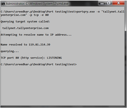

Port query is a command-line utility that you can use to troubleshoot TCP/IP connectivity issues. The utility reports the port status of target Transition Control Protocol (TCP) and User Datagram Protocol (UDP) ports on a remote computer. You can run Port query on Windows Server 2003, Windows 2000, and Windows XP.
You can also use Port query in the following ways
● To troubleshoot Active Directory issues in which you have to verify basic TCP/IP connectivity. This can be especially useful in environments with firewalls
● To verify connectivity to TCP/IP ports that are used by Active Directory for Lightweight Directory Access Protocol (LDAP), remote procedure call (RPC), and Domain Name Service (DNS).
Download Link
http://www.microsoft.com/en-in/download/details.aspx?id=17148
For more details, refer the Article Link

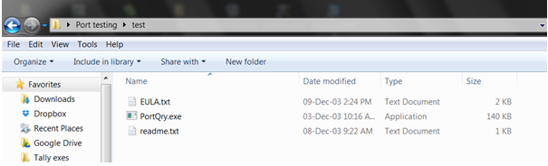

How to use port query tool?
Command line: portqry.exe -n “tallynet.tallyenterprise.com” -p TCP -e 80 or 9050.
Locate the folder in command prompt and mention the above command:
Result details
● Listening : A process is listening on the target port on the target system. Port query received a response from the port.
● Not Listening : No process is listening on the target port on the target system. Port query received an Internet Control Message Protocol (ICMP) "Destination Unreachable - Port Unreachable" message back from the target UDP port. Or, if the target port is a TCP port, Port query received a TCP acknowledgement packet with the Reset flag set.
● Filtered : The target port on the target system is being filtered. Port query did not receive a response from the target port. A process may or may not be listening on the port. By default, TCP ports are queried three times and UDP ports are queried one time before reporting that the target port is filtered.
If you get the result as FILTERED as shown in snapshot below , then, a firewall or VLAN could be blocking that port.
